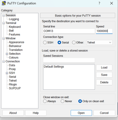

This is my PuTTY terminal configuration, although I don't think that should be the factor here:

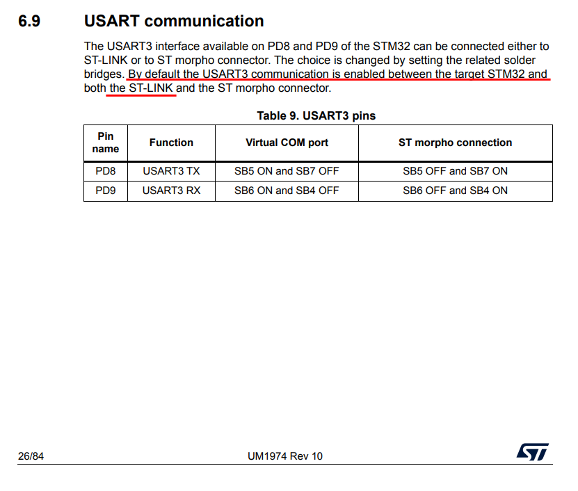

You haven't said what board you are using, or how you are connecting the UARTs to the PC (COM13)?
If you're using an ST board, with built-in VCP (Virtual COM Port), then you will need to make hardware changes for that to use a different UART - see the User Manual and/or Schematics for details.

Most probably, the UART3 pins of the MCU are connected to the ST-Link adapter, and printf works via the VCOM interface provided by the debug adapter.
If you want to use another UART, you need to attach a USB-to-Serial adapter (or something similiar) on your own.

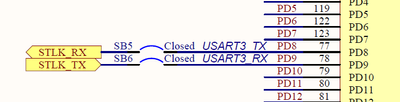

If you are using NUCLEO-F746ZG board, that's normal. USART3 is connected to STLINK-VCP (Virtual ComPort), while USART2 NOT.
From the bord schematic:

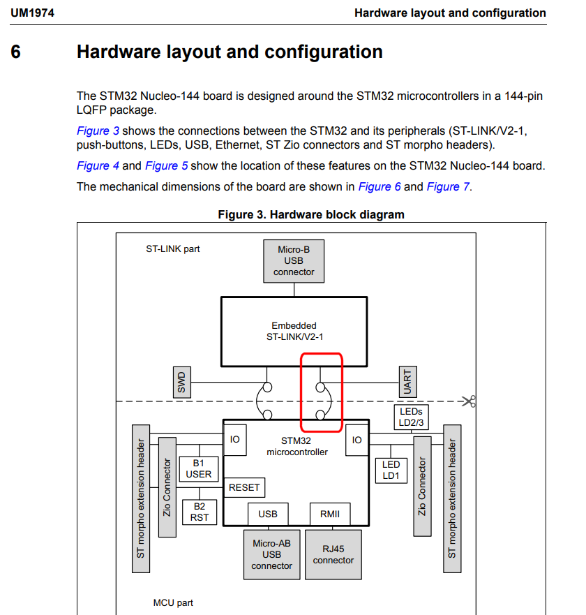

@Andrew Neil wrote:If you're using an ST board, with built-in VCP (Virtual COM Port), then you will need to make hardware changes for that to use a different UART - see the User Manual and/or Schematics for details.
I am not very sure whether my board has VCP, but based on what I just read online, I think it does, since I don't have any other hardware that is connected between my laptop and the STM32 board.
So I am assuming there is no way for me to use any uart other than uart3 by changing like code/pin configurations, and I will have to like change some physical connections on the board to do so?
Thanks!

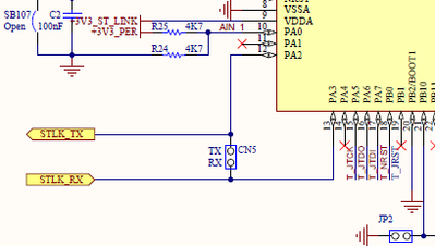

2025-06-17 1:41 AM - edited 2025-06-17 1:43 AM
If you need to use USART2, you need to connect USART2_Tx and USART2_Rx to respectively to STLINK_Rx and STLINK_Tx over CN5:
But you need to keep USART3_Tx and USART3_Rx pin not initialized (Hi-Z).

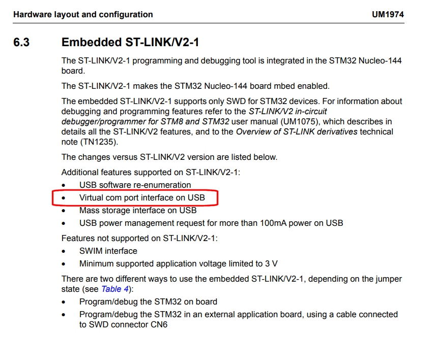

@is45 wrote:not very sure whether my board has VCP, !
The User Manual is the place to check that:
via: https://www.st.com/en/evaluation-tools/nucleo-f746zg.html#documentation
