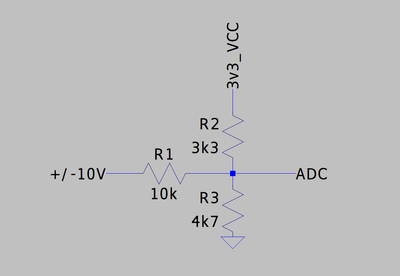

If you use "standard" VDD = 3,3V and (3v3 = VDDA=vref+ ) , ADC can convert 0...3,3V ;
most simple solution is using a divider at input, + offset , like this:
But dont forget : do always "reference zero calibration" , because 0,0V input is about half of full scale at adc input.
So to get some +/- result, you have to do:   (adc_value) - (adc_value at 0 V input) = (+/- result)

hi @epsi1on
you can use normalization to shift the signal for better representation, before that use voltage divider circuit to reduce your range from (-10 to +10) to (3.3 to 0)
