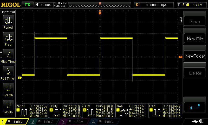

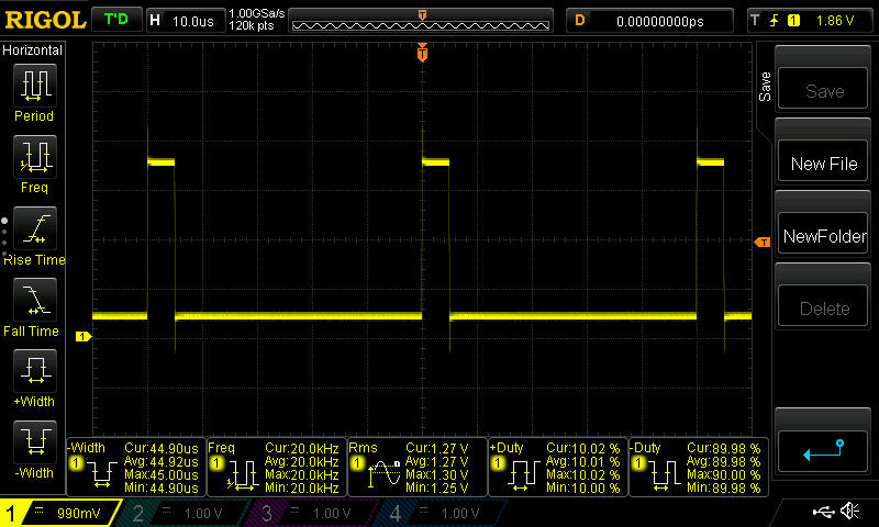

When do i set TIM_ClockDivision in my code , the duty is 50% , but i know i set the Compare4 to other value in time base init , and it does not be 50%.
And when i put this line to comment, the code do correctly.it does not be 50% duty cycle.i see that with oscope.
i dont know why this activity occer.
the register in default mode has 0x0000 value , and when i comment the line of set clockDivision , it has zero value,and if i uncommented this line and set to zero , the code do the activity wrong.why??
i mean this line:
TIM_TimeBaseStructure.TIM_ClockDivision = 0;
this is my code with the uncommented line that there is above:
thanks alot.
#include 'stm32f10x.h'#include 'stm32f10x_gpio.h' // for Enable LCD#include 'stm32f10x_rcc.h' //for Enable LCD#include 'stm32f10x_tim.h'#include 'LCDLib.h'#include 'delay.h'void tim_init(void);void GPIO_init(void);int i = 0;int main(){ lcd_init(); lcdPutString ('Believe Your Dreams.'); GPIO_init(); tim_init(); while(1){ for(i = 0 ; i<=200 ; i=50) { TIM_SetCompare4(TIM3, i); lcdGoxy(1 , 4); lcdPutInt(TIM_GetCounter(TIM3)); delay_ms(80); }// for(i = 500 ; i>=0 ; i--)// {// TIM_SetCompare4(TIM3, i); // delay_ms(8); // } } }void tim_init(){ RCC_APB1PeriphClockCmd(RCC_APB1Periph_TIM3, ENABLE); TIM_TimeBaseInitTypeDef TIM_TimeBaseStructure; TIM_OCInitTypeDef TIM_OCInitStructure; TIM_TimeBaseStructure.TIM_Prescaler = 30; TIM_TimeBaseStructure.TIM_Period = 200; TIM_TimeBaseStructure.TIM_ClockDivision = 0; TIM_TimeBaseStructure.TIM_CounterMode = TIM_CounterMode_Up; TIM_TimeBaseStructure.TIM_RepetitionCounter = 0; TIM_TimeBaseInit(TIM3, &TIM_TimeBaseStructure); TIM_OCInitStructure.TIM_OCMode = TIM_OCMode_Toggle ; TIM_OCInitStructure.TIM_OutputState = TIM_OutputState_Enable; TIM_OCInitStructure.TIM_Pulse = 0; TIM_OCInitStructure.TIM_OCPolarity = TIM_OCPolarity_Low; TIM_OC4Init(TIM3, &TIM_OCInitStructure); TIM_OC4PreloadConfig(TIM3, TIM_OCPreload_Enable); TIM_Cmd(TIM3, ENABLE); }void GPIO_init(void){ RCC_APB2PeriphClockCmd ( RCC_APB2Periph_GPIOC| RCC_APB2Periph_AFIO, ENABLE ); GPIO_InitTypeDef gpioAa; gpioAa.GPIO_Mode = GPIO_Mode_AF_PP ; gpioAa.GPIO_Pin = GPIO_Pin_9; gpioAa.GPIO_Speed = GPIO_Speed_50MHz; GPIO_Init( GPIOC, &gpioAa ); GPIO_PinRemapConfig(GPIO_FullRemap_TIM3, ENABLE); }2018-03-28 4:40 AM

yeah , got it.
but when is do that, i think the toggle mode dose not work.
i mean , when i set a value to CCR4 register :
TIM_OCInitStructure.TIM_Pulse = 30;
however i have 50% duty cycle in a period.
the period value is 200 and i know that is wrong in toggle mode,but when i comment the line TIM_ClockDivision , the toggle mode work correct.
i think when the timer value = pulse then toggle happent.
but here toggle happent at half of period always.
when TIM_ClockDivision compile with other line.
when TIM_ClockDivision not compile with other line.and in my idea this activity is true in output compare mode toggle.
thank you.
