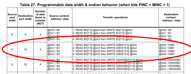

I'd expect 8-bit memory read and 16-bit peripheral write to behave in a predictable way. Perhaps not the way you want.
2017-09-18 5:34 AM

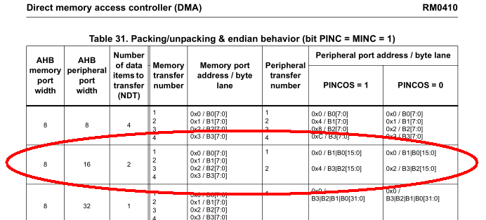

There are basically two ditinct DMAs in the STM32 (the OP didn't care to tell us the model he is using):
In the simpler one used in 'F0/'F3/'Lx , in this case the controller expands the upper 8 bits by 0.
In the complex dual-port DMA ('F2/F4/F7), there is a FIFO inserted into the data path. If FIFO is not used (aka Direct mode) such transfer is impossible, as in that case the memory-side width-setting is ignored. If FIFO is used, the controller always reads at least 4 bytes into FIFO (bytewise if set so) and then writes the concatenated result halfword-wise into the peripheral port.
Neither case fits OP's need.

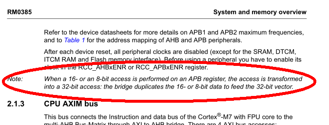

That ''works'' because it's *not* an 8-bit write:
UARTD6.usart->TDR = (uint8_t)val;
Look up how is the structure containing TDR defined - most likely TDR is defined as uint16_t. Thus, the line above tells the compiler to *read* 8-bit from address given by val, and then write it into address give by TDR according to its definition (i.e. 16-bit), which involves an implicit conversion from unsigned 8-bit to unsigned 16-bit, which according to rules of C is extension by zeros.
Look at the generated asm (disasm).
8-bit write might in C look like:
*(volatile uint8_t *)&UARTD6.usart->TDR = (uint8_t)val;
Trying to write 8 bits into the UART (TDR) via byte wide DMA seems to result in whatever appears in bit 0 of TDR getting reflected into bit 8.
This is the expected behaviour with true 8-bit write:

LL_USART_TransmitData9(USARTXX, usartCharSendBuffer[idx_send++]);I want to use the DMA to minimize the IT requests but I have the similar issue as @Community member (but I want to have a 16 bits buffer) : whatever data size I set for the memory and the peripheral's sides, the bit 0 of TDR is reflected into bit 8. It acts as the TDR forces the DMA to work with the LL_DMA_MDATAALIGN_BYTE option. Despite I set:
dma.MemoryOrM2MDstDataSize = LL_DMA_MDATAALIGN_HALFWORD;
dma.PeriphOrM2MSrcDataSize = LL_DMA_MDATAALIGN_HALFWORD;
Reference manual says:
• To write the halfword “0xABCD�?, the DMA sets the HWDATA bus to “0xABCDABCD�?
with HSIZE = HalfWord
• To write the byte “0xAB�?, the DMA sets the HWDATA bus to “0xABABABAB�? with
HSIZE = ByteDoes someone know if I missed a setting or if it is a limitation of the STM32F334xx's UART?
