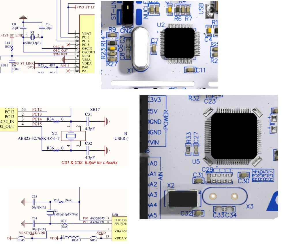

page does say that the 070 chips do NOT have a ''crystal-less'' USB. but page says that they DO. the says that ''the clock source must use an HSE crystal oscillator'' but no the NUCLEO-F070RB does NOT have a crystal. here (see below) are the parts from the that illustrate the hardware:in the image you can see crystal X1 connected only to the STLINK interface, you can see crystal X2 which is 32kHz, and you can see crystal X3 which is SUPPOSED to be connected to the 70RB chip according to the schematic, but it is clearly absent on the board itself. and yes i checked and that's what my board looks like. there is no crystal X3. the board is MADE by ST, and i did have a working USB connection on it, so i still dunno what to think. either the ST people need to proofread their docs, or there just isn't a definitive answer to this question. the circuit i'm making uses a 500kHz PWM and i have to be certain that the USB signals will have enough fidelity to work.

As Kraal suggested, your Nucleo board is likely using the MCO (Master Clock Output) from the ST-Link. Although the F07 is not using the crystal directly, it's essentially the same as the 8 MHz crystal clock.
You should be able to put an oscilloscope probe on 'U5B pin 5' or the SB50 bridge and see an 8 MHz clock.

OK thanx i found what you're talking about. yes there is an MCO signal going to the 70RB chip. so it does have an external clock pulse. i been misled because of implications that i never tried to verify. the X3 is missing because it's an option in case i separate the STLINK from the uC. still,
