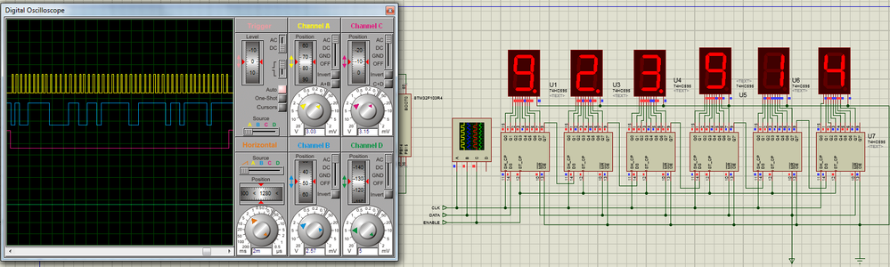

2019-02-27 8:36 AM
Do not use scanning method.
Display with hc595 output.
display doing blink
The display does not remain steady when operating.
I suspect Spi.
I need help
thanks

2019-02-28 3:20 AM
You don't include the circuit. My guess would be you are clocking from the buffer shift reg to the output shift reg every clock rather than every 8 clocks.
2019-02-28 4:41 AM
Thank you so much.
