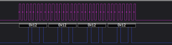

2025-02-27 6:42 PM
hspi2.Init.DataSize = SPI_DATASIZE_32BIT;---------------->8BIT
hdma_spi2_tx.Init.PeriphDataAlignment = DMA_PDATAALIGN_WORD;------->BYTE
hdma_spi2_tx.Init.MemDataAlignment = DMA_MDATAALIGN_WORD;------>BYTE

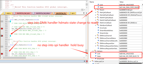

2025-03-03 6:43 PM
maybe a misunderstanding of Polling vs. INT-mode, vs. DMA-mode?
If you use SPI in DMA mode: you should only use DMA related interrupts, such as DMA done.
INT-mode related interrupts are not needed - and I think, not enabled, not used anymore.
If you configure SPI in DMA mode -potentially the INT-mode related interrupts are not enabled, not configured (and not needed).
Just in INT-mode, you get interrupts related to SPI busy, empty etc. In DMA-mode - and if you get DMA INTs - these are the only hooks to synchronize. You cannot mix INT and DMA-mode (and their interrupts).
