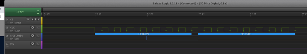

I have configured SPI2 on STM32L476RG as Master Half Duplex, clock = 4MHz, CPOL = 1, CPHA = Edge 2. I am connected to a Pololu 2736 demo board (LSM6DS33). The timing diagram for the part shows resting clock as high (CPOL = 1) and MISO being clocked in on falling edge (CPHA - Edge 2). I have verified:
My while loop code looks like the following as I am just trying to read the WHO_AM_I register:
HAL_GPIO_WritePin(SPI_CS_GPIO_Port, SPI_CS_Pin, GPIO_PIN_RESET);
txBuf[0] = 0x0F;// | 0x80;
txBuf[1] = 0;
HAL_SPI_Transmit(&hspi2, txBuf, 2, 50);
HAL_GPIO_WritePin(SPI_CS_GPIO_Port, SPI_CS_Pin, GPIO_PIN_SET);
HAL_Delay(20);I always receive 0x00 back. I have tried spacing out the register transmission with the dummy clock transmission (for reading) by 1ms as well and see no difference. Can anyone give my an idea as to what I have missed?????? I have gone as far as also writing to the CTRX1 register to enable the accelerometer out of low power mode before the read just in case it had something to do with that and it still didn't work......

UPDATE:
If I change to 0x8F and 4 wire SPI I see the MISO line putting out 0x69 (the correct value)....But how can I get this to show up on the MOSI line in 3 Wire mode (Master Half Duplex )???
