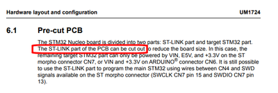

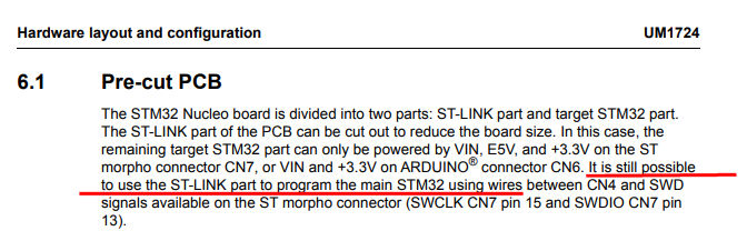

@marcogrossi89 wrote:However, if I remove the ST-Link part of the board, how can I reprogram the MCU
Read the rest of that paragraph:

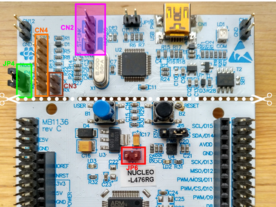

Here's a picture from @MM..1 showing where to break:
Taken from this post: https://community.st.com/t5/stm32-mcus-products/stm32-mcu-choosing-and-programming/m-p/657536/highlight/true#M239953

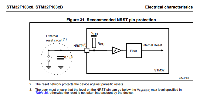

You don't tie NRST to anything - it has an internal pullup:
