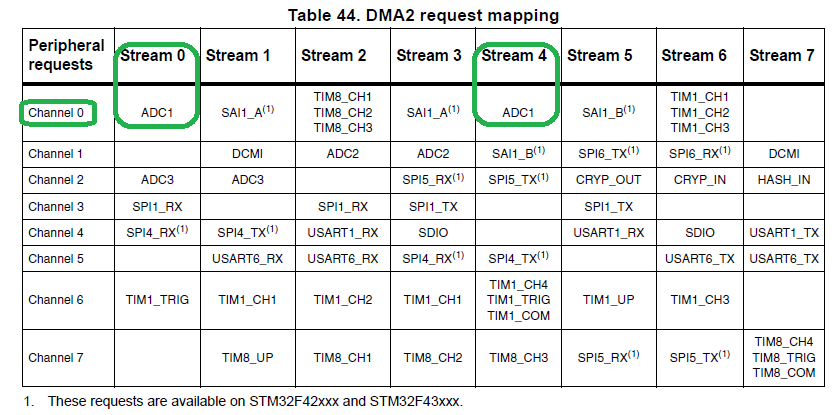

ADC1 is on Channel 0, Stream 0 or 4. See RM00090 Rev 5 Reference Manual, Table 44.
Cheers, Hal2014-01-04 5:19 PM
Yeah, Stream4 should be fine.
2014-01-04 6:08 PM
Just to clarify - Tomas' code is attempting to use Channel 4.
Cheers, Hal2014-01-04 6:33 PM

You mix variable definitions, with function calls, this is a very C++ construct, so just checking.
As Hal highlighted, and I diagrammed your real problem is the Channel4 is not usable as it has NO connectivity to ADC1 Further if you use Stream4 then you need to be examining the TC4 flags, as they are interrelated. You can define the body for the IRQHandler functions in any source/objects files you choose, the linker resolves that. C++ mangles names based on parameters, so the linkage would not occur, and the weak definition would prevail.2014-01-05 12:08 AM
I mixed up ''stream'' and ''channel in stream''. I fixed it, but the code still doesnt work. Program never break on breakpoint in DMA2_Stream4_IRQHandler.

2014-01-05 5:09 AM
Size appears correct, it's in units of transfers, not bytes
DMA_InitStructure.DMA_PeripheralInc = DMA_PeripheralInc_Enable;
No, don't do that you want it to remain pointing at ADR1->DR, the timer triggers the ADC start, the ADC EOC triggers the DMA
