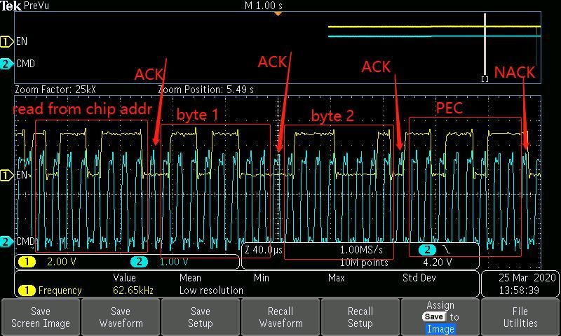

1.When I was debugging mlx90615, I used smbus to communicate. The reading function was as follows:
uint32_t I2C_Read_Cmd_Data (SMBUS_HandleTypeDef *hsmbus1, uint16_t chip, uint8_t *cmdBuffer, int32_t cmdBufferLen, uint8_t *dataBuffer, int32_t dataBufferLen)
uint32_t ret_code = I2C_OK;
if(HAL_SMBUS_Master_Transmit_IT(hsmbus1, (uint16_t)chip, (uint8_t*)cmdBuffer, 1, SMBUS_FIRST_FRAME)!= HAL_OK)
while(1);
while(HAL_SMBUS_GetState(hsmbus1) != HAL_SMBUS_STATE_READY);
if(HAL_SMBUS_Master_Receive_IT(hsmbus1, (uint16_t)chip, (uint8_t*)dataBuffer, 3,SMBUS_FIRST_AND_LAST_FRAME_WITH_PEC) != HAL_OK)
while(1);
return ret_code;
but the measurement waveform found that there was always no ack in the last byte (pec), as shown below
Would like to ask where the problem is, please answer, thank you very much
2.As shown above, I have the following options for the last parameter(XferOptions) when using the HAL_SMBUS_Master_Transmit_IT function, the waveform will change when I modify it, I would like to ask how to configure this parameter, thank you!
