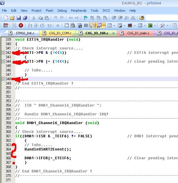

The question is, what do i wrong? How you can see in the picture (µVision - Debug mode) is there a code for the ''EXTI4_IRQHandler'' but not for the ''DMA1_Channel6_IRQHandler''.  But how can it be?

Seems like the optimizer got rid of your code. The link between the actual interrupt vector and your function is in the startup file (startup_stm32f10x_xx.s). In that assembly file the interrupt vector table is filled with ''weak'' references, e.g. if the linker finds your function DMA1_Channel6_IRQHandler, it should use that reference, otherwise it'll use the dummy loop in the startup file.
Clean your project, rebuild everything and then start looking whether your function is externally visible, e.g. makes it into the object file and map file as a symbol. From the screenshot it didn't look like the function was marked ''static'' so the linker should pick it up.

The vector is missing from your startup file, or the startup file is not being linked in, and the linker is therefore dumping the code as it has identified it as being unused (ie nothing references it).
If you used one of the standard demo/example projects from the library code it would have complete startup/vector code and it would call the DMA1_Channel6_IRQHandler()
Cut the project down to a small workable example, and either validate it for yourself, or post it.

Ok, I found the problem. Indeed the reason for it is in the startup file ''STM32F10x.s''. µVision does create the startup file ''STM32F10x.s'' with wrong IRQ handler names.
In my case the DMA channel handlers did not be called ''DMA1_Channel6_IRQHandler'' and ''DMA1_Channel7_IRQHandler'' but ''DMAChannel6_IRQHandler'' and ''DMAChannel7_IRQHandler''!
