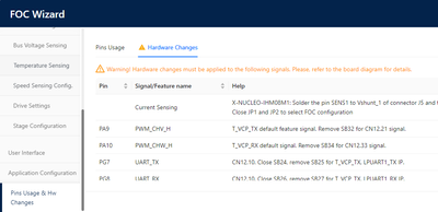

Pin 1 of CN11 and CN12 of NUCLEO-U575ZI-Q must be connected to Pin 1 of CN7 and CN10 of X-NUCLEO-IHM08M1.
Refer to the Workbench pins usage and hardware changes tab for hardware modifications if needed.
