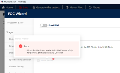

i m using customized stspin32g4ACT board , nd version of work bench m using is 6.3.1 but when i try to generate code there is motor profiler option is disable although m using stm32ide 1.17.0 when i upload code for led blink using pc14 it turn but don't blink but when m upload code through Arduino it blink very good pc14 and pc13 both in st32ide it does not blink show suggest me where i lacking motor m using is 2 pole hall sensor code is blow , i m new to workbench so pls guys guide me
nd this is disable motor profiler image
