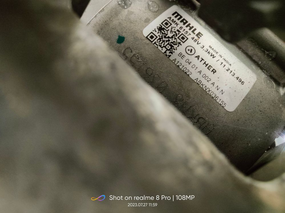

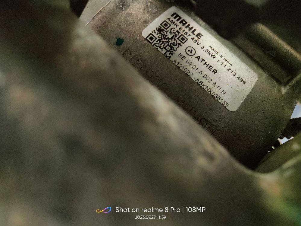

we have a ather electrinc schooter ,they have used the 48 volt motor .motor image is attached .i am confusing that for this motor which board we can use for no load run ?

Hello @Ranjeet Singh
I suggest the St Mc Suite tool, which lists you the Motor Control compatible boards with the details, Here is the link : https://www.st.com/st-mc-suite/home/
- Click on - Start -> Engine Control Solution
- select the motor type (BLDC)
- select the algorithm
- then choose your board in Power Board
The STEVAL-CTM009V1 board can meet your expectations.
Regards

hi @Zied b.
at 48 volt using STEVAL-CTM009V1 board what maximum current we can draw from this board ?
i think 104 A . am i right ?
For the voltage you are looking for, you have EvalStDrive101
