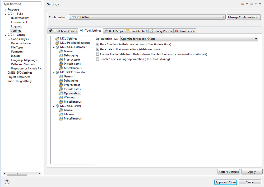

This error :
"The Monitor gives the following faults:
1) FOC duration.
2) Software error."
It seems to be an Optimization issue.
Please be sure to compile your program in release mode and run your project in this mode.
In Release Mode you are in "Optimize for speed".
To have a look on this setting :
1) Right Click on your on project in STM32 Cube IDE Project Explorer
2) Properties
Let me know if it was your problem.

Hello PPati,
This error :
1) FOC duration.
2) Software error."
2) Properties
