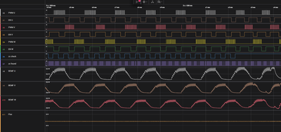

This is a capture figure of ESC control for drone, using Logic Por.
