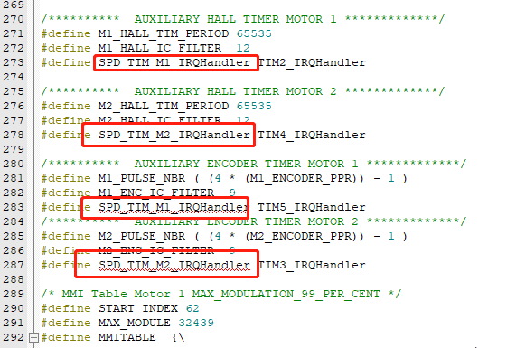

I had a mc sdk problem like as this question: https://community.st.com/s/question/0D53W00000S6AdLSAV/driver-motor-program-error-when-i-use-hall-sensor-and-encoder-at-the-same-time
My platform is: stm32f446re, MotorControl Workbench 5.4.7,mdk-arm v5,STM32 F4 FW V1.26.1.
I used both the Hall sensor and the encoder, the encoder serves as the Main sensor and the Hall sensor as the Auxiliary sensor.
when I build the code, there is a warning: ../mx/Inc1/parameters_conversion.h(283): warning: #47-D: incompatible redefinition of macro "SPD_TIM_M1_IRQHandler" (declared at line 273).
when I run and debug the code, it alway run to the default_handler.
when I disable the irq of the tim2 tim3 tim4 and tim5, this would disappear.
Could you fix this bugs?
