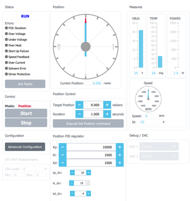

Below, I have attached a graph obtained using ST Motor Pilot V6.4.0 that shows the I_Q_MEAS and I_Q_REF signals of the PMSM motor during vibration in standstill (Although I couldn't take a screenshot as I wanted, it's clear that the I_Q_MEAS and and I_Q_REF signals are oscillating). As far as I understand, the I_Q_MEAS and I_Q_REF signals should remain stable when the motor is stationary.

Through the Motor Pilot Interface, click Advanced Configuration while in the RUN state to dynamically change the Position PID regulator values. For example, decrease the Kp value by 10 and check if it improves steady-state stability.
