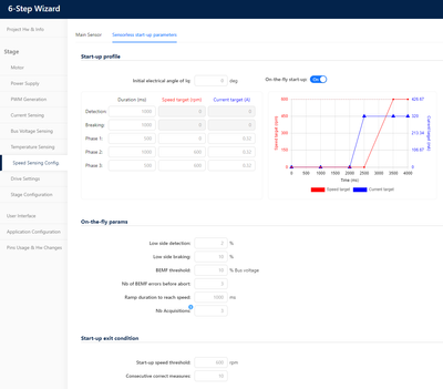

Hi TKara.2,
if you are using the MCSDK6.4.0, you will find the "On The FLy" feature designed for the 6step algorithm. This will allow your motor to restart from a spinning state with no revup phase, as described into the "Six-step Firmware Algorithm" user manual (chapter 5.1.6 Rev-up component and On-the-fly start-up) embedded into the MCSDK Workbench tool.
Please refer to User Manual documentation available through: "Workbench tool">About>Documentations>Documentation>"User manual" tab>"Six-step Firmware Algorithm" link
To enable the feature, you must set the On-the-fly start-up bit into the MCSDK6.4.0 Workbench, and regenerate the project.
Best regards.
