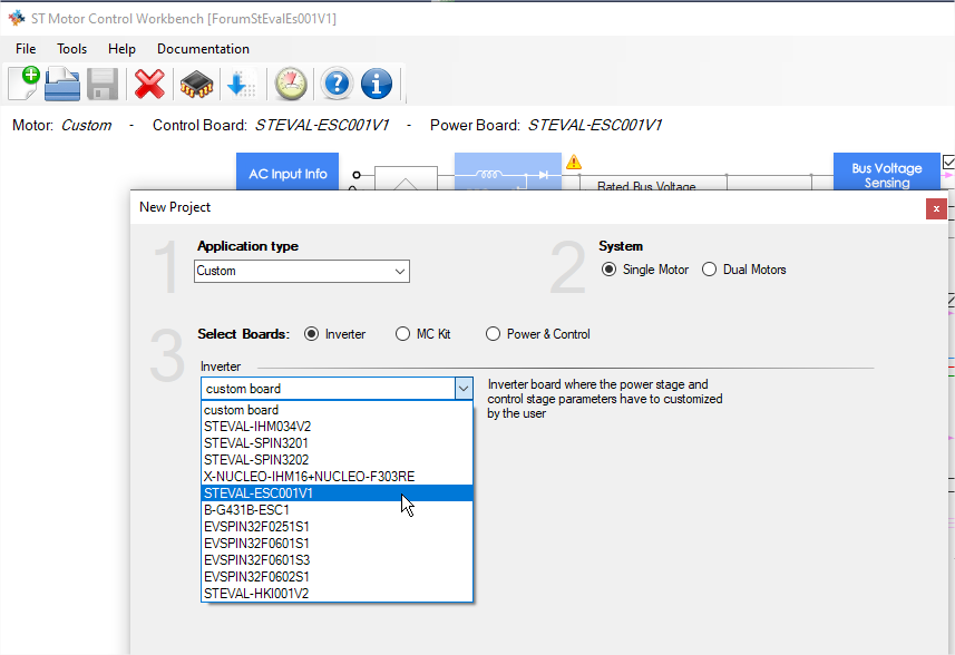

Could you try using Workbench MCSDK5.4.8 e.g.? You can generate your project as below:
Best regards.
GMA
2022-07-19 7:29 AM
Thank you for your answer. I ended up using Motor Control Workbench 5.Y.4 following an answer by KnarfB, to a related question. I think a key part of the puzzle for a newcomer is to realise that you have to select from inverter rather than Power & Control.

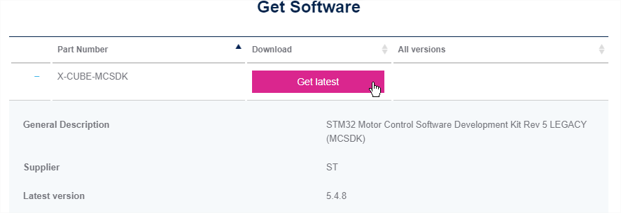

2022-07-26 9:54 AM
I tried to find it anyway but after many searches at st.com the best I can get is says
No results found for: workbench MCSDK5.4.8. Showing the results for: pworkbench.
Perhaps only employees have access to this software?
2022-07-26 11:12 PM
Please try:
https://www.st.com/en/embedded-software/x-cube-mcsdk.html#
