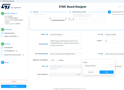

Hello @EH,
On MCSDK6.3.2 delivery, you can use the "STMC Board Designer" to describe your custom control board (user manual is available clicking on "About" box).
As example, cloning NUCLEO-G474RE board, you are able to change the MCU type:
ST provides ST Motor Profiler tool, refer to User Manual documentation available through "Workbench tool">About>Documentations>Documentation>"User manual" tab, "Motor Profiler Application Note" link.
