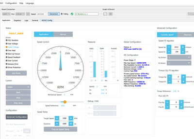

Please can anybody helps me why I'm getting under voltage notification and I'm using in the power supply 12 volts, so I need to ignore this notification and it just run once and after that I need to repeat the same step everytime, please if anybody can give me feedback or how to solve this issue.
I'm using the SPIN3201.
