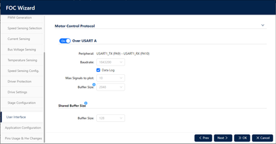

Before going further, could you confirm that you generated a Motor control project with MCSDK 6.2.1 ?
The connection with ST Motor Pilot requires a software protocol which comes with a Motor control project only if it is enabled. To do so, go in the User Interface section, and check that the Motor Control Protocol over USART A is enabled as shown below: (look also at the Baudrate, it is the one you have to apply at MC Pilot side)
Once your project is generated, compiled and flashed to your MCU, you can connect the Pilot only if the MCU is not paused. So be careful if you attached a debugger that it did not break the processor.
Let us know if it helps.

Thanks, It is 6.2.1. I generated and compiled a sample application, but have not flashed it yet (I wanted to check motor parameters). I shall flash it to the MCU... this part was not done yet. I shall let you know the results. BTW, the Interface sectoin of the SPIN3204 board is a bit different. Here is how I set it up.
2023-12-18 7:49 AM
Your settings are perfectly fine and aligned with your STSPIN32F0. But yeah, if you do not flash your code... no chance to connect !

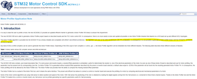

Hello @ranrang ,
I am sorry to read that our MCSDK did not satisfy your expectations.
If I am right your configuration is based on a STSPIN32F0.
But if you read the introduction chapter of the Profiler Application note you can see the line I just highlighted:
STSPIN32F0 embeds an STM32F0, therefore profiler cannot work with your configuration.

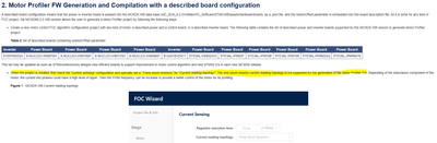

If you read the chapter just after the introduction, you can find the following line:

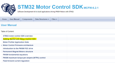

In a previous post you mentioned "Not arguing, however, there isn't a clue that I should download first the application to the board."
In the Getting Started with Motor Control SDK, you can find the following instructions.
