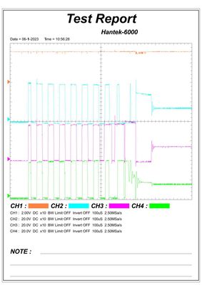

This is the 3v3 supply and the first few High side gate PWM pulses. At the end is where the Hardfault / Busfault occurs.

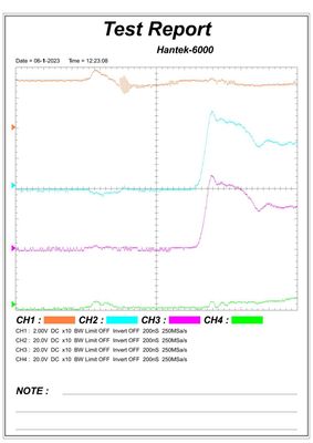

Looking closer and triggering off the 3v3.
Would this be enough to cause the Hardfault? (I have checked the ADC supply pin and this glitch is not visible with this being filtered).
If so I'll have to move on to the next reiteration of the PCB, (more layers, more shielding, shorter tracks) which is waiting a final look over.
However if I change just the current range back to 40 amps all is OK. This does seem odd to me.
Thanks for your time and consideration.
