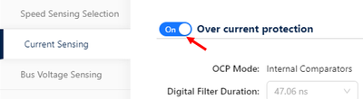

@Hello @PCama.1,
After modifying parameters on workbench user interface, you should generate the project with workbench tool first (only running CubeMx at this point, will use the current unmodified .ioc file).
OC/DP protection could be disabled on workbench user interface:
