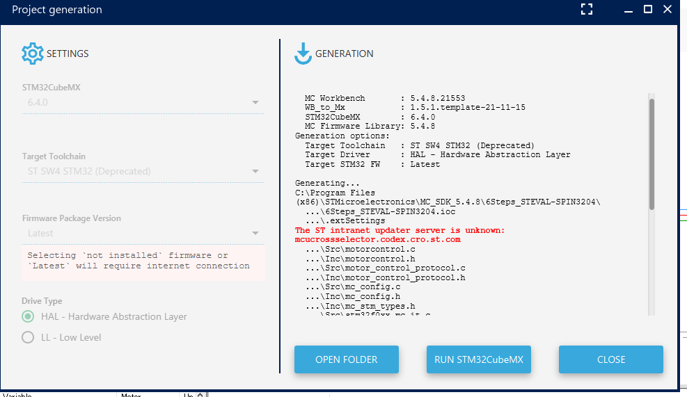

I am using STEVAL-SPIN3204 to drive the BLDC motor. I'm using a "Motor Control Workbench" to get the code for vector control, but I get an error when generating the code. Does anyone know a solution?

Dear @�?�雅 矢島
You have to install STM32 FW.
Best regards
