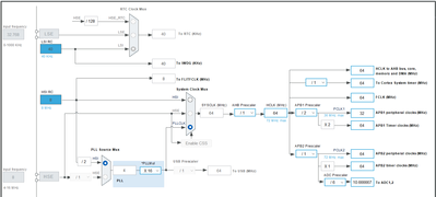

This is the mcu clock setup.

64MHz system clock should be enough even with the pathetic Cube/HAL interrupt handling to capture something like a 1kHz signal. Try incrementing a variable qualified as volatile.
