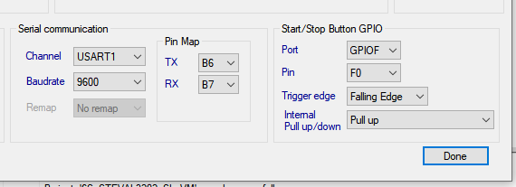

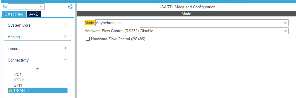

Setting up 9600 baud rate (same as in Cube MX settings). Using correct COM port.

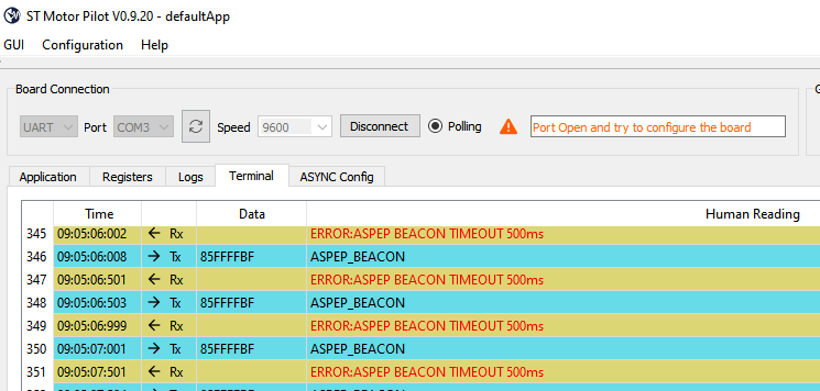

I am trying to connect with ST MotorPilot - result:

0693W00000KaAmgQAF.png0693W00000KaAnyQAF.pngit does not blink red/green USB LEDS and result is the same, no matter whether If close J9 or not and reset the MCU.
Result is the same, :
What am I doing wrong?
Should I Run or Debug?

Hi GMA,
Thank you for the answer.
I ran WB4.5.8
0693W00000Kaa09QAB.pngNow UART is active.
I am not sure where I can find  UART IP  (digital i/o box) on Workbench interface.
In MX, Hardware control is disable by default.

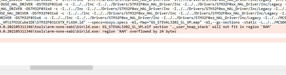

After attempt to copmpile and run:
It does not fit to RAM by 24 bytes.
How can I fix this?

GMA
Could you try using "LL - Low Level" for "Drive Type" on Project generation option?
If you agree with the answer, please accept it by clicking on 'Accept as solution'.
Best regards.

EShaw.1
Associate II
Hi GMA,
Thank you very much!
I changed the Drive Type as you suggested.
Now UART communication with Monitor works.
Regards,
Edward.
