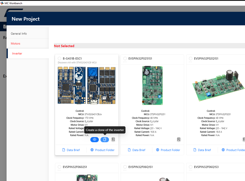

I am trying to run The Motor Control Work Bench using my custom board. I created an inverter profile by cloning one of the existing boards, as below.

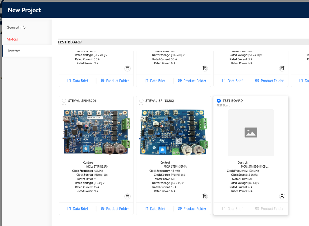

_legacyfs_online_stmicro_images_0693W00000bkIuHQAU.pngI made the necessary changes to map pinout of my board. The board appears on the inverter page, as below (referred as TEST BOARD).

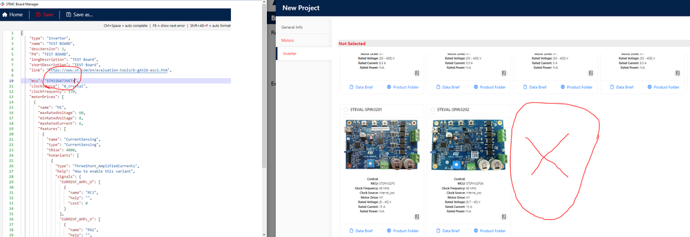

_legacyfs_online_stmicro_images_0693W00000bkIsgQAE.pngHowever, if I change the MCU to STM32G473VETx , the board immediately disappears from the list and I cannot use it to create my Motor Control Project.
_legacyfs_online_stmicro_images_0693W00000bkIugQAE.pngHow to fix this?
I noticed, it's only taking MCUs that are already existing in the Motor Control Work Bench, for example, STM32G474QETx, STM32G431CBUx etc. But how do I make it to work with my MCU (STM32G473VET6)?

Hi. Read the last addition to my post "Newly created Inverter disappears from MCWB 6.1.2 new project wizard.". I have found that the inverter does not appear in the wizard with a specific temperature range number at the end of the MCU number. For me, STM32G431RBT6 is invisible, STM32G431RBTx is fine.
Try editing your new board in Board manager and change STM32G473VET6 to STM32G473VETx and I think you may find it appears.
