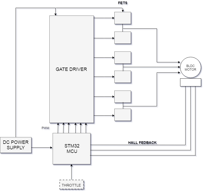

I am developing bldc drives using stm32f103c8t6 MCU. And by using inverter circuit we drive the bldc motor using stm32. Block diagram of drive is shown below
But I would like to know if any library is available for stm32f1** (for trapezoidal control). So that i able to see difference and get corrected myself.

Th X-CUBE-SPN7 package may help you: https://www.st.com/en/embedded-software/x-cube-spn7.html
It provides a 6-Step implementation that targets STM32F103 devices.
