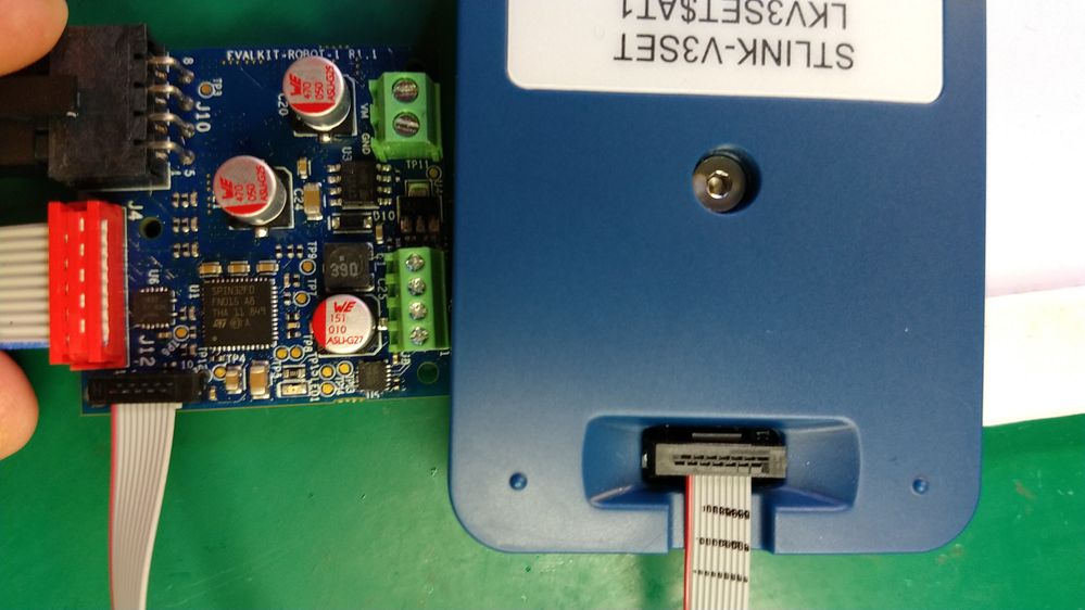

Hmm, I must say I got this Kit because I thought it would be a good solution to get up and running quick.......im kinda dreading it now. Im not liking the almost non existing documentation. I've not used the stlink v3 or st products before and I am at a loss to even get started..which cable where. Im glad that at least there is some fixes Chaalyy and I really look forward to getting something usable. I've got a fairly decent little lab here for SMD work and perhaps Ill post some images of those resistor changes if it helps anyone.

It would be great of more of a walk through/documentation with setting these headers to the stlink v3 /including photos as its not included in the manual

I have the STLINK-V3SET in use and it´s fairly easy to connect. On the back of the debugger, you´ll find a 10x2 pin header, on the pcb of the STEVAL-ROBOT-1, you´ll find the same header. So just connect the (with the debugger) included flat cable at both ends, plug in a micro usb cable into the debugger and you´re up and running...

Thanks Chaaalyy! Here is a photo of the programming cable hooked up in case it wasn't clear for anyone else. I did measure out those resistors and they all seem 100 ohm to me so should be ok. (the comm connector isn´t connected directly to the f0-mcu.)--geez. I would have thought to go with I2c not modbus but thats later/at the moment I dont even have a usb to rs485 so in the main loop I will probably also fiddle around there. Anyway I only got it today so tomorrow should be fun...I hope
