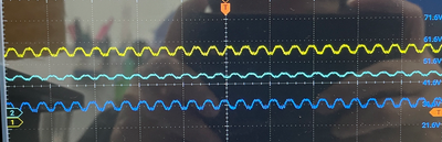

Hello egarcialopez,
Thank you for guiding me to use a low-pass filter to successfully display the saddle waveform.
Although the attached waveform still requires some further adjustments, it already shows the result I was aiming for.
Once again, I sincerely appreciate your guidance!
Hi Vincent7,
you are welcome. Nice traces :).
It looks like there is a little ripple, maybe you can adjust the capacitor to a higher value so the cut frequency of the LPF is lower, closer to the frequency of the sinusoidal wave. Or add a second pole with a series inductor. But if you only need to have a general idea of what the phase voltage looks like, the filter that you are using is good for you.
