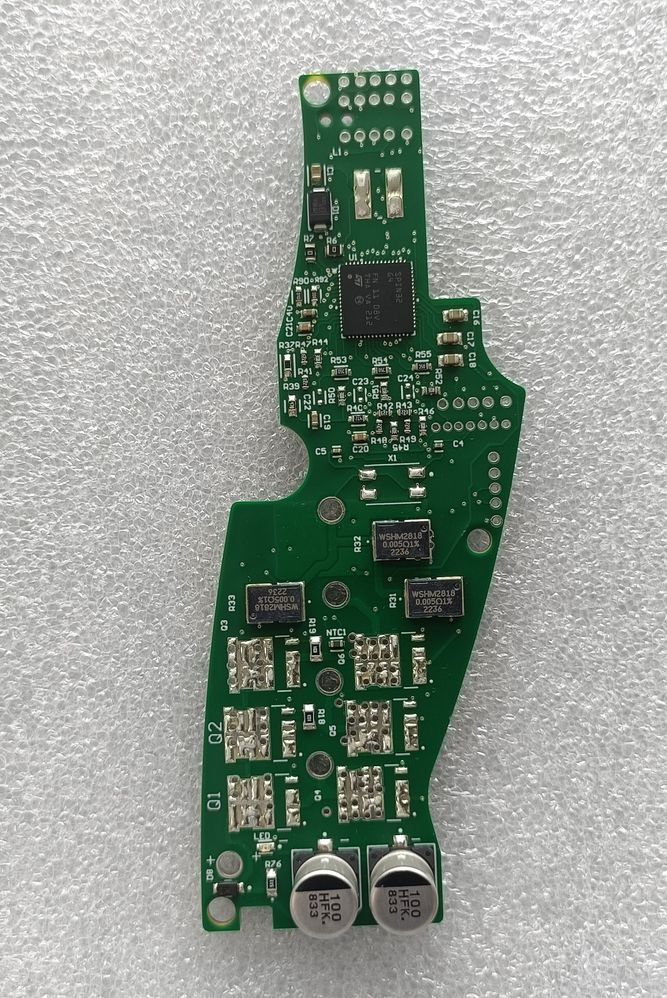

I have built an ESC based on STSPIN32G4 and created a software for it using MC SDK. I did select the following in MC Workbench: Inverter, EVSPIN32G4. Did not change any other options. Schematic of my PCB is based on the EVSPIN32G4 electronic with 1-to-1 pinout.
Behaviour when I power-on my board:
I am still able to flash any other of my demo software on this board and it works (triggering GPIOs, communicating over USART and I2C) but I am still not able to let the "original" software generated by MCSDK to run.
Does anyone has an experience with this issue? Do I need to set some specific options in MCSDK to let software run on STSPIN32G4?
On the picture you can see the ESC part of my board.
Thank you in advance.

Has there been any progress on this? I am experiencing a very similar problem. I also built a custom PCB largely designed based on the EVSPIN32G4, generated application through MC Workbench but the system is not working fully.
Like @HAL-9000 I am also using STLINK-V3SET to program the board.
I am using CubeIDE 1.8.0, Motor Control Workbench 5.Y.3, and CubeMX 6.3.0
All the power seems fine, VDD, VDDA, VCC, etc. I ran some unit tests on basic functionality and the board is running, but the motor control software is not.
I had to jump through hoops to get SysTick_Handler to be called, so that USART would also work. With this solution https://community.st.com/s/question/0D53W0000181KD7SAM/stm32cubeide-17-mcu-package-l4-series-117-vtor-is-not-initialized
As an interim step, I have also trying to come up with a unit test for the gate drivers so that I can test the power stage of my board, but have not been able to. I thought about simply driving one of the Mosfet high gate side high, while driving another Mosfet low gate high, while keeping all other gates low. I am driving WAKE high and so on. I seem to be getting a pin READY set from the control logic, but I believe I am missing something.
Is there a simple code and configuration to test the STSPIN32G4 that is properly connected to a board?

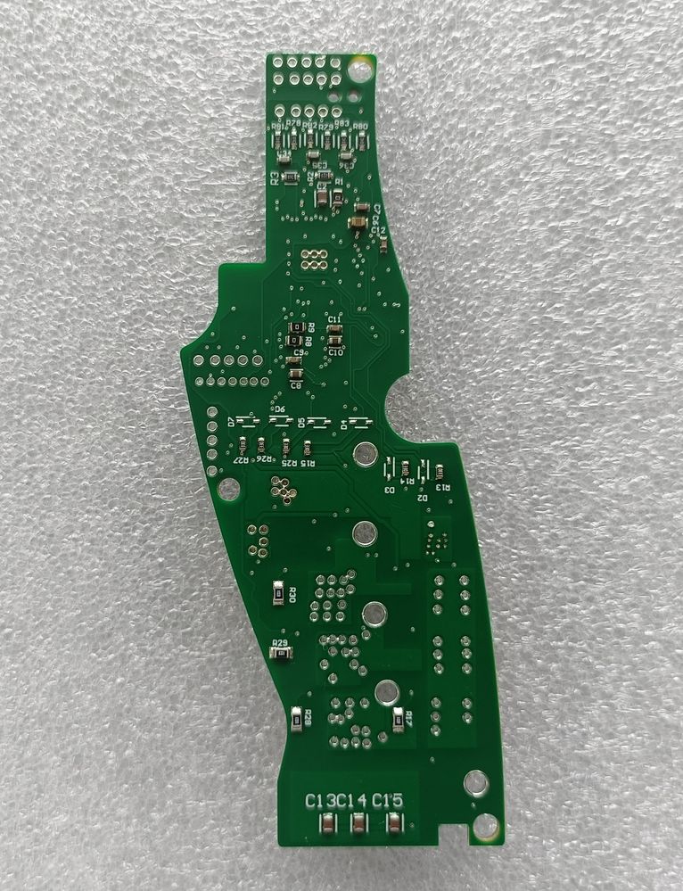

Hi @PCama.1 @Laurent Ca... @Szhen.11 @HAL-9000 ,
I have a problem with my custom stspin32g4 board ( see photos attached).
I have tested with my MOSFETS and buck converter inductor.
The STSpin32g4 controller gets hot once I connect my MOSFETs, especially the GLS3 MOSFET.
The motor pilot goes to the STOP state whenever I click on start on the motor pilot, and the controller gets hots ( see video attached)
However, whenever I remove the MOSFETs, it goes to the START state on the motor pilot, and the controller doesn’t get hot.
I have checked for partial contacts and cannot find any within the PCB circuit.
My circuit was made exactly from the EVSPIN32G4 schematic.
I would be very happy if you could link me to the technical team of STSPIN32.
Thank you very much,
