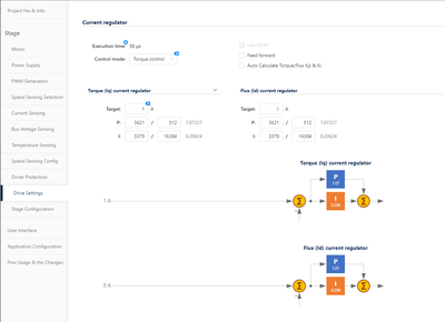

You can also tune the Torque PID values to have a more reactive response (by increasing the integral part for example):
If you agree with the answer, please accept it by clicking on 'Accept as solution'.
