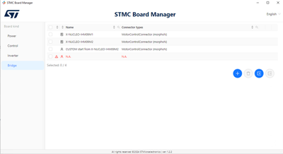

Update, using the STMC Board Manager I seem to be able to add a Bridge/Adapter.
However still unable to configure it using the STMC Board Designer.
