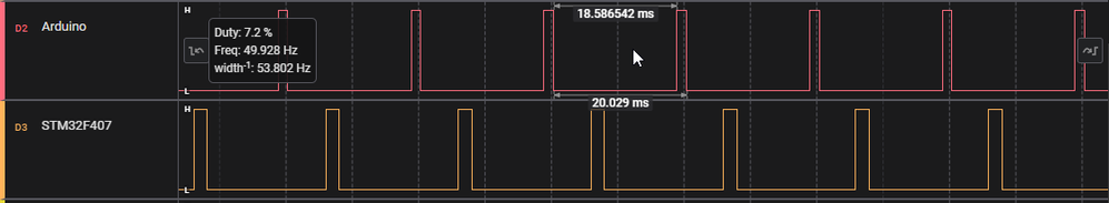

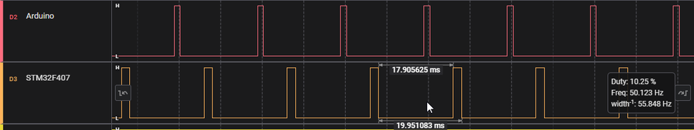

Hello, I am trying to learn bare metal programming and servo motor control with my stm32f407g-disc1 card.
I cannot move the servo motor with stm. I tried with arduino to check if the problem is in the motor and the motor worked. I thought my PWM signal was wrong and I found codes from the internet but it didn't work again.
I am attaching the code and logic analyzer graphs. Can you help me what could be the problem?

Edit: I tried with HAL library but nothings change. Is it possible my STM is broken?
For HAL library, I follow this videos instruction: https://www.youtube.com/watch?v=owbuhblItBA
2023-02-11 9:11 AM
Okay, after researching the problems for two days, I bought a new servo motor of the same model. And code is working with new motor. I still have no idea why the old motor does not work with stm32.
I didn't see anything about closing the topic, but if any mod sees this message, you can close the topic.
2023-02-10 6:13 AM
what about the logic level?
Is your arduino 5v and your stm 3v3?
2023-02-10 6:33 AM
Yes, arduino gives 5v and stm32 gives 3v3 output voltage.That sounds like it could be a problem, but I didn't see anyone except me using the same card and the same motor and having problems. Am I missing something?
