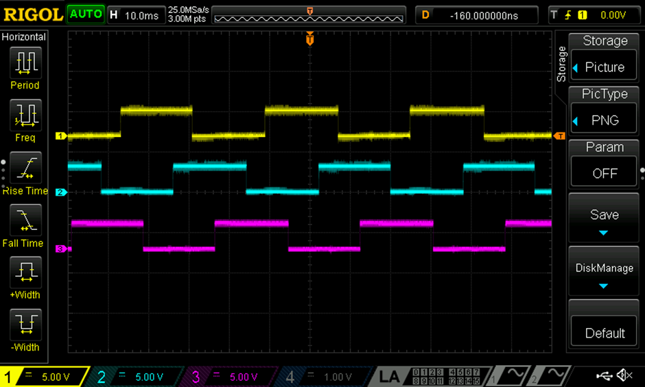

I've confirmed its hall sensor output with an oscilloscope. I've attached my waveforms:

probe the Phase voltages of the motor.
Chances are youre not respecting the PWM deadtime, what modulation are you using, trapezoidal?
