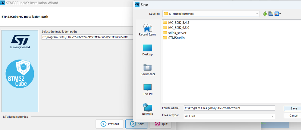

I have been getting an error while using MC Workbench to drive ihm03 motor and motor driver package,
i haven't satisfied by the answers in forum so i solved it in a different way.

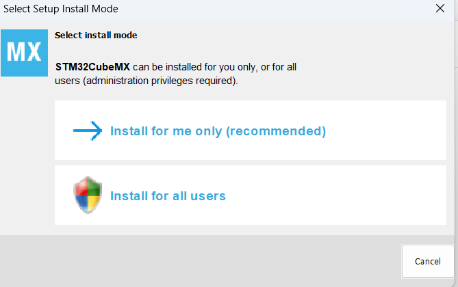

At first in installation phase (while setting up STM32CubeMX), i was chosing "Install for me only (recommended)" option for installation mode therefore MCSDK was not to be able to see it from its path.
To solve my problem i decided to choose "Install for all users" option. Then now i can generate code in MCSDK.

2024-07-18 3:50 AM
Sure Amina,
I have had clicked "Install for anyone using this computer" in MCSDK installer setup.
