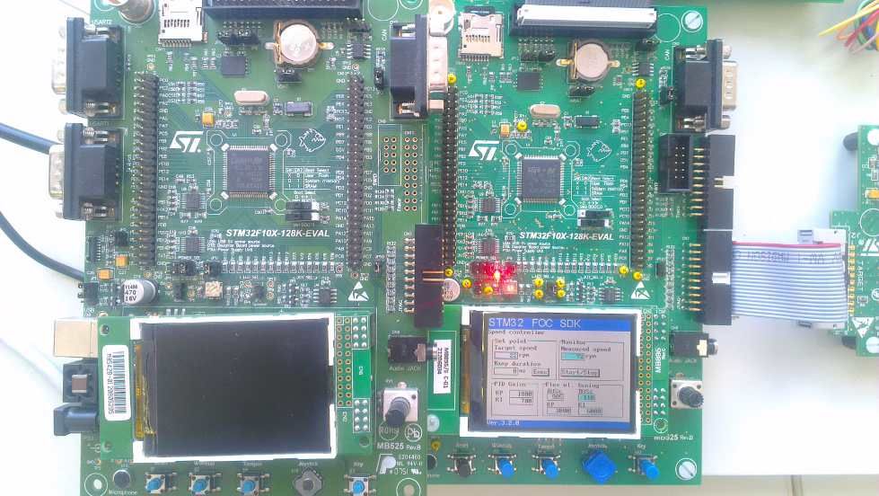

it works now. I first used my older MB525 REV B Eval Board with the MCKit and got the described problems. With the the MB525 REV B which is delivered with the MCKit it works. Same firmware and same connections. Something has changed with boards although the Rev is the same - the left one is the older board that doesnt work with encoder. Perhaps a known error.2013-03-14 4:17 AM

Ciao Alexander,
regarding the control board that doesn't works maybe it is just matter of jumper settings. It is not possible to changhe the main speed sensor from hall/encoder to sensorless on the fly. This feature is not implemented in the firmware. Regarding the PI controller using the monitor feature of ST MC Workbench is possible to change in real time the proportional or integral terms of each controller (don't worry if the LCD screen is not updated). Ciao Gigi2013-03-14 4:46 AM
