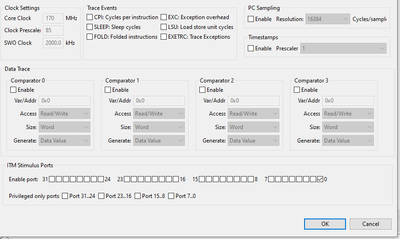

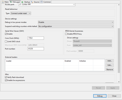

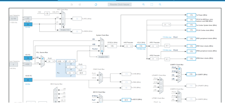

2023-12-18 6:02 AM
Hello again,
Thank you so much for your response and suggestions. Unfortunately, I'm still facing the same issue where the ITM debugging is not functioning correctly with the STM32 MotorControl Workbench.
I've attached images showing my current settings to give you a better understanding of my setup. Interestingly, when I use the project without the STM32 MotorControl Workbench, the ITM debug messages work perfectly. It's only when I integrate the STM32 MotorControl Workbench that I encounter this problem.
Could there be a compatibility issue between the MotorControl Workbench and ITM debugging? Or perhaps there's a specific setting within the Workbench that needs to be configured for ITM?
Any further assistance or insights would be greatly appreciated, as this issue is proving to be quite perplexing.
Thank you once again for your time and help.
