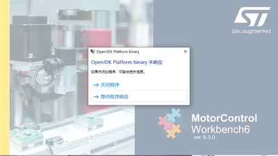

btw, when I open the Workbench, many times I get this as below
even when I used STM32cubeMX, I got the openJDK issue, how can I do to deal with it?
Thanks.
2024-10-14 1:23 AM
Hello @dqsh06,
Could you provide us some details:
- What are your used MC Workbench version and STM32CubeMx version?
- What is your Operating System version and language?
- What is your Java JRE and JDK versions? If old versions are used, is it possible to update it?
- Do you have the same issue on another PC?

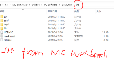

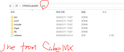

2024-10-15 11:02 PM
hello @GMA
- MC Workbench Ver6.3.0, STM32CubeMX ver6.12.0
- OS: windows10 professional 22H2, Ver19045.4780, simplified Chinese.
- JRE is within MC workbench. jave version: 11.0.20.1, JRE version:11.0.20.1+1-LTS
I am not sure it is older or not, it was installed by MC workbench Ver6.3.0
but there is another JRE, which is within STM32CubeMX, java version: 17.0.11
why MC workbench and STM32CubeMX are not the same jre? I dont know, it was installed by ST.
below as your reference.
- I only has 1 PC, I am not sure on another PC.
Thanks.
2024-10-25 12:35 AM
Hello @dqsh06,
As error is not systematic, could you verify, via your task manager, that no OpenJDK process remains active once all WB/CubeMx processes are closed?
May be that using MC Workbench Ver6.3.1 could help.
