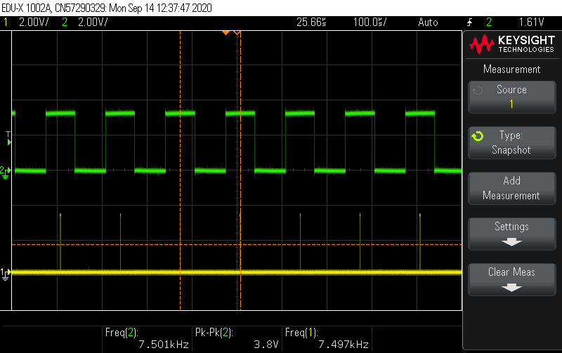

Green signal is the pwm pulse and the yellow one is PB12. Which finds the center portion pwm.

I have tried that TDK but cant able to get the output at the middle of the pwm. Because by using External trigger the adc will measure at the beginning.
