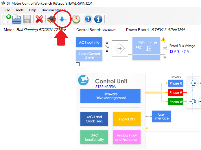

Hello Dario,
Sorry for my late Reply, i was stuck with some Project with higher priority in my company.
Unfortunately not i've tried till yet i couldn't get the board to work.
But Maybe i'm wrong by the way to program and use the board. I've tried to use the MCSDK
The files has been generated as you can see in the Picture.
And i would like to use the STM32CUBE IDE or could,
you tell me why the most People using the Keil IDE for ST ARM Microcontrollers?
And is there a detailed description like an step by step guide with this board and also for the STEVAL-ESC002V1.
hopefully you can help me.
And Thank you for your support till now.
Best regards Alex

Hello Alex
Never mind for the late reply and of course take your time :smiling_face_with_smiling_eyes:
In general there is no preferred IDE: MCSDK supports IAR, Keil and the STM32CubeIDE and TrueSTUDIO.
However..... for the specific project of the six-step for STEVAL-SPIN3204, only the IAR EWARM 8 or Keil uVision 5 are supported.
This limitation is because this example project was initially developed using these two IDE versions.
You have to select one of the previous two IDE, otherwise you can have a code generated, but it does not run properly.
My suggestion is to delete what have already been generated and start from scratch opening again the example project from MCSDK.
This is because the example updates the present code and some previous parts of code still remain in the updated code.
Try to follow exactly, step by step, what described in the “readme.txt�? file.
This file will open automatically when you load the project.
If something is not clear in this file, please come back and ask.
