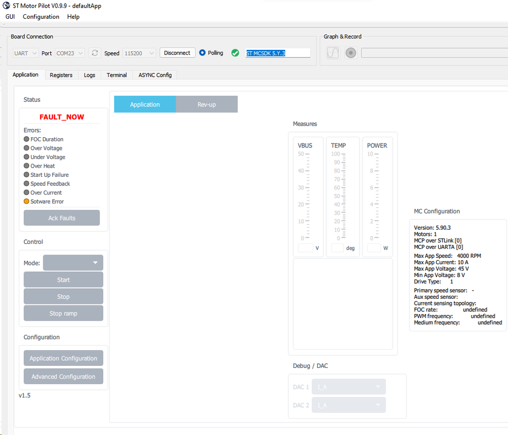

0693W00000HrfGFQAZ.pngI'm working with the STEVAL-SPIN3201 board
I have compiled and uploaded example "6s_STEVAL3201_HS_VM"
I have a 70mm diameter sensored BLDC motor
When I connect through the software ST Motor Pilot V0.9.9 click in "Start" Motor and the motor turns 1/4 turn and stops .

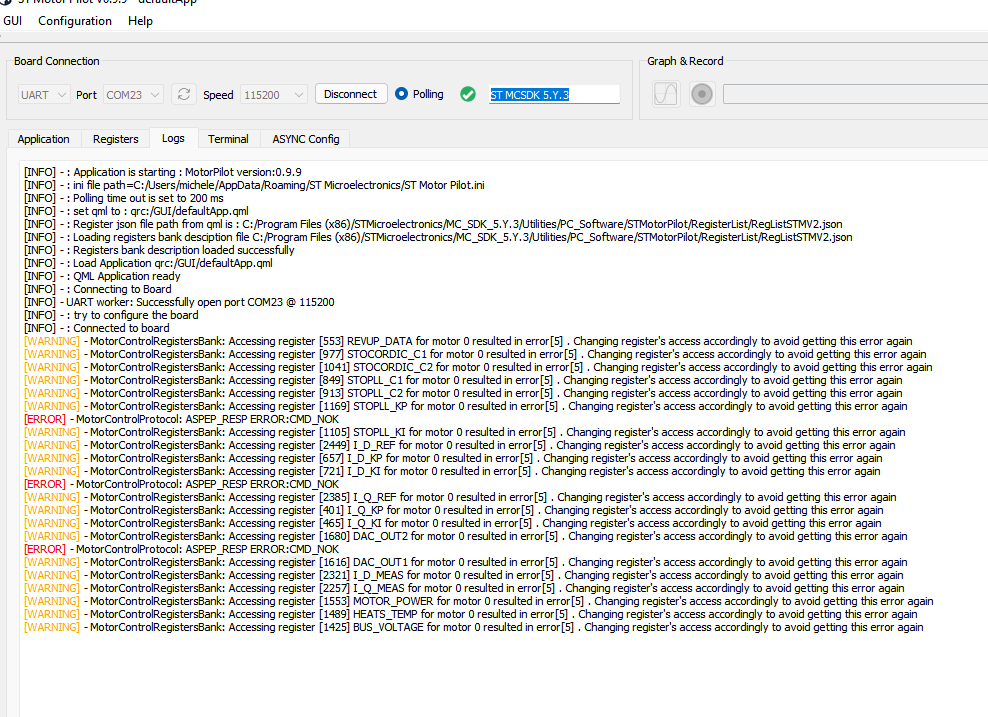

I get a "FAULT_NOW" error message "Software Error" . In Logs
"[ERROR] - MotorControlProtocol: ASPEP_RESP ERROR:CMD_NOK"
I use ST "MCSDK 5.Y.3" version.
