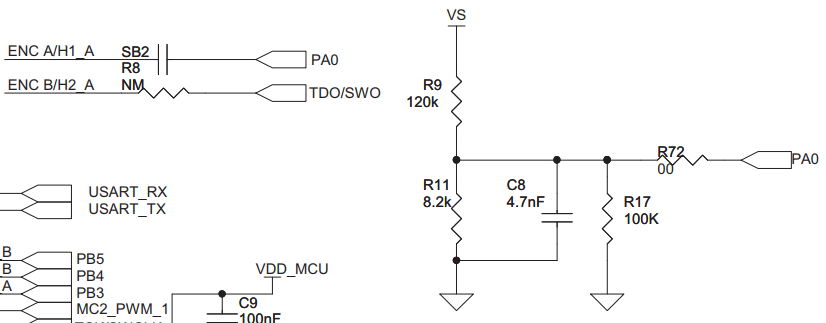

I tried to generate the MCWB project starting from yours, but looks like the STEVAL-IHM042V1 doesn't support a dual-motor driving where both motors use Hall sensors and 3-shunt sensing.
In fact the Hall3 input of motor 2 is shared with one of the current sensing input:
And Hall1 of motor 1 is shared with voltage sensing.
You should change your target topology if you want to use this board.
In any case, I attach you a WB projecthighlighting all these problems.
