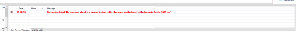

I am using STEVAL-IHM042V1 and Motor Control Workbench. Everything was working fine until I tried to connect the board via the Motor Profiler. STEVAL-IHM042V1 is not available for Motor Profiler so I chose other board with same L6230 driver. Since that, I cannot connect my STEVAL-IHM042V1 in Motor Control Workbench – I get an error „Connection failed...According to the error message I tried following:
checked the power supply,
checked and tried all possible baudrates, COM address and other settings in Windows device manager,
tried various cables,
updated ST-Link driver via ST-Link Utility,
installed (updated) STM32 Virtual COM port on my computer,
tried all these things on other computer.
None of these worked. The User manual says that the board is mounted with STM32F103C8 preprogrammed with STM32 Virtual COM Port firmware providing USB-serial interface. Is it possible that the firmware was erased somehow? Eventually, can I reprogram it?

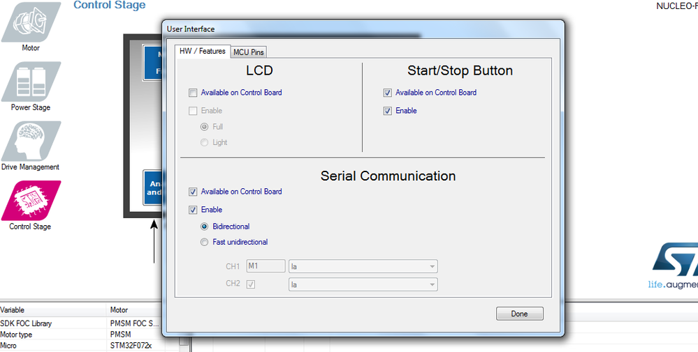

In order to enable the communication between the board and the Workbench GUI you must enable the UART communication option before compiling and downloading the FOC library.

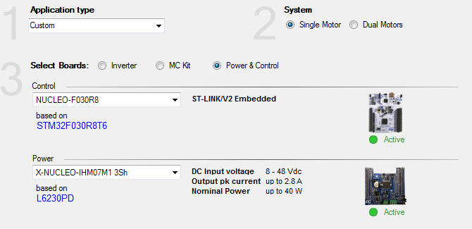

Step 1 - Create a new project using the control board and the driver board you selected:
Step 2 - Configure the FOC algorithm according to your needs

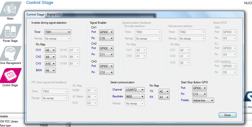

Step3 - Enable the UART communication in ''control stage'' tab:
Step 4 - Check the baud rate (selecting 9600 is recommended for STM32F0 family)
Step 5 - Generate the configuration files, compile and download the firmware into the Nucleo board
Step 6 - Connect the workbench to the board using the virtual COM provided by the Nucleo and setting the same baud rate selected in firmware compilation steps.

2017-12-05 3:07 PM
Gerber, you have to: Click New Project -> select dual -> select inverter
Then the STEVAL-IHM042V1 is in the drop down.
