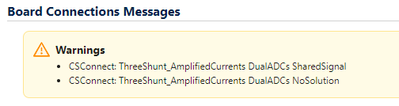

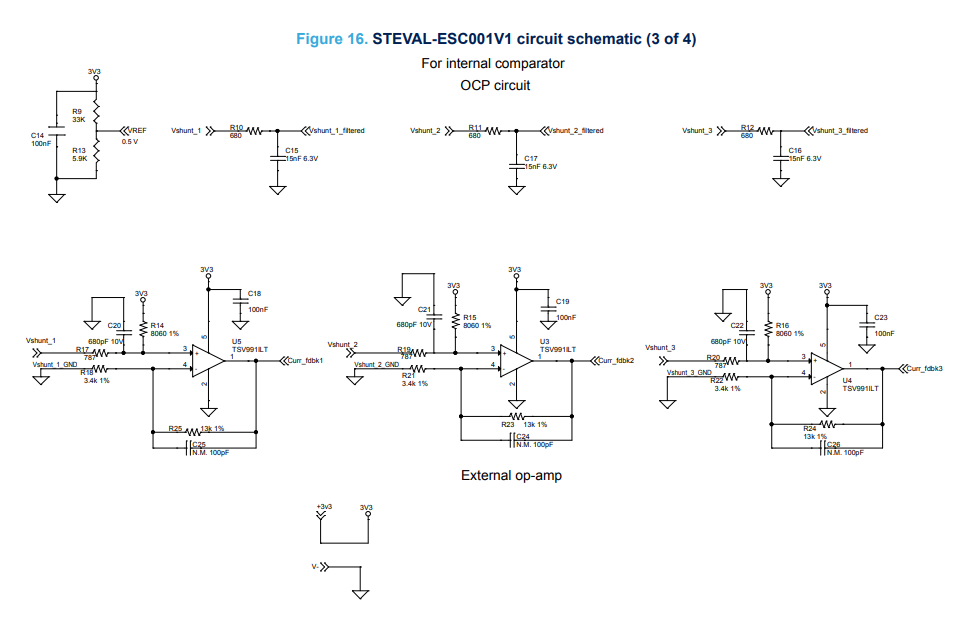

It may be because of above warnings verify the schematic for current sensing section and MCSDK configuration again.
As per the schematic in the document  UM2197 - User manual
 The OCP circuit is available in the schematics. But im unable to configure the OCP circuit and the MCSDK software shows the hardware doesn't have the OCP. Kindly help me to find where does the problem arises.

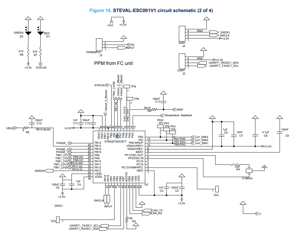

Additionally, the .ioc file that I generated does not configure the following pins as per the schematic:
PA7, PB0, PB11 → Vshunt_filtered
PB12, PB13, PB15 → Phase1, Phase2, Phase3 respectively
These pins are not explicitly configured in the CubeMX .ioc file.
Do these pins need to be explicitly configured (analog or digital) in the .ioc file or need not to be?

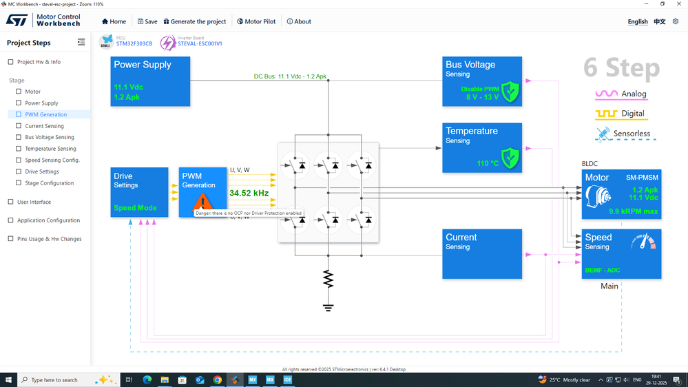

I have generated the code. But the final settings shows danger here due to no ocp or driver protection enabled.
While I check for the OCP protection, I have came to know that this hardware doesn't have support for OCP protection and I have no idea that where does the driver protection is available.
Kindly help me with this.

Before making these changes, could the above conditions cause any issues in running the motor using PWM input?
If no, can i try run the motor without making changes.
Best regards,
Santhosh.
Hi @STuser2
My question in short is
whether the above condition actually cause any problem to motor or driver while operating?
Best Regards,
Santhosh
It does not create issues, if you are working under controlled conditions like power source etc only ensure short circuit does not happen which may damage your hardware, but the basic doubt is whether the motor will run without current sensing. You can try and check for pwm and current feedback etc.

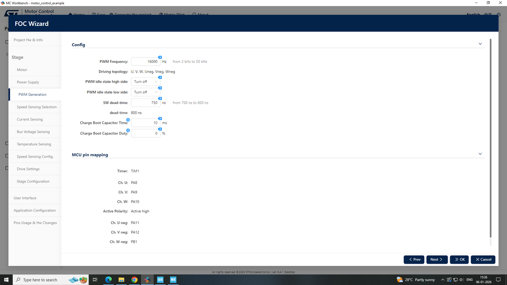

I have dumped foc algorithm code to the esc. And i have given the pwm pulse of frequency 16Khz and changed the duty cycle from 10 to 90% to the pwm input pins.
But, there is no response from the motor. is calibration is needed for this esc to get input? If yes what is the procedure to calibrate this esc?
