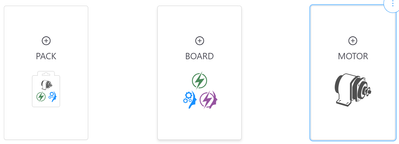

1. Click on New project in MCSDK
2. Click on Motor
You press the one i have shown.

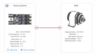

3. Then go the path of the motor .json files
C:\Program Files (x86)\STMicroelectronics\MC_SDK_6.4.1\Utilities\PC_Software\STMCWB\assets\hardware\motor
Copy of one of them and paste in any of the local folders.
4. Rename and edit the motor parameters according to your requirements.
5. The motor will be reflected as shown below which i imported
6. select the hardware STEVAL-ESC001V1 in boards and create and generate the code.

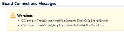

Note:  There are 2 warnings observed
I am not sure of the impact, but code generation is successful.

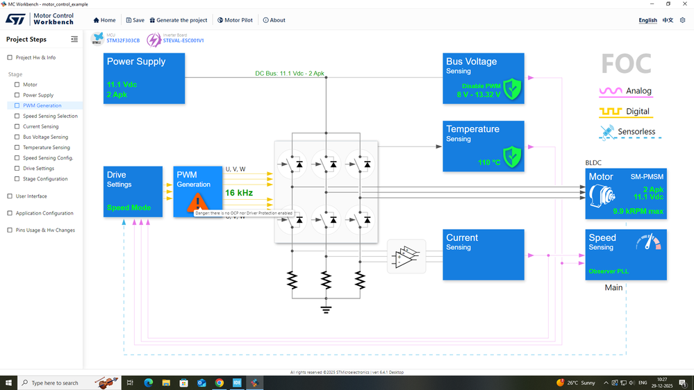

Hi @STuser2,

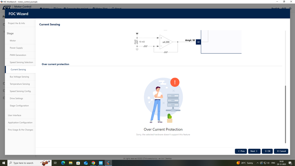

I have generated the code. But the final settings shows danger here due to no ocp or driver protection enabled.
While I check for the OCP protection, I have came to know that this hardware doesn't have support for OCP protection and I have no idea that where does the driver protection is available.
Kindly help me with this.
