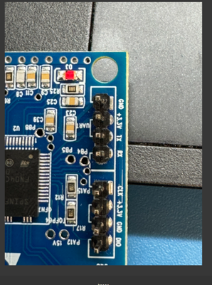

Debug mode means running fine with IDE .
Got this issue rectified as on board Tx and Rx labelled in reverse.
When i connected Tx of USB to ttl to TX of board and Rx to RX of board , connection build .
Thanks for your support and reply.

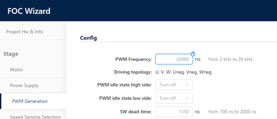

2025-07-29 12:15 AM
i tried reducing the baud rate still it didnt help .
2025-07-29 12:22 AM
Hello @IC5151,
Decreasing PWM frequency:
